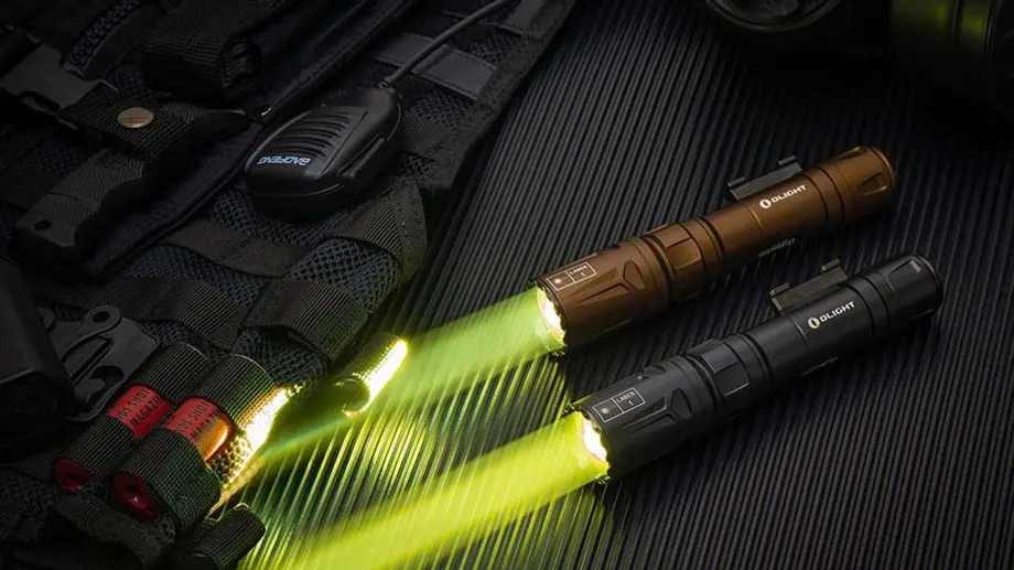

Something to keep in mind is that the Odin turbo technically a laser so you are not going to get that spill or that flood surrounding that center hot spot like you would with a traditional flashlight like the warrior x turbo. It’s kind of like marauder 2 where it might appear kind of yellowish and that is to keep things safe for your eyes when it is close up but when it’s a distance the way that you’re supposed to use an LEP it’s is white. It might look a little bit different on camera but this is more of just a regular kind of a neutral white looking beam versus it being yellowish when it’s super close up.
The warrior x turbo has that bigger head and it’s a more traditional style thrower the way the technology is where it has a deep smooth wide reflector with a small LED so you getting that more of a standard type thrower looking beam whereas with the LEP it’s a laser so it’s going to be a lot tighter it’s not going to have that spill like the warrior x turbo.
