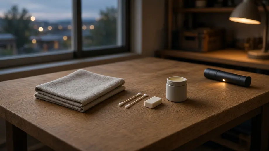

How Do I Clean Flashlight Battery Contacts?
To clean flashlight battery contacts, switch the light off or lock it, remove the tail cap and battery, and rub the battery ends, the tail spring and the head contact with a clean pencil eraser or a clean, dry cloth. Wipe the threads and the flat contact rim, reinstall the battery with the positive end toward the head, and screw the cap fully home.
Olight's manuals don't spell out a contact-cleaning method, so the steps below use the battery maker's and another flashlight maker's published advice. Duracell's battery care FAQ says, "For best performance, keep battery contact surfaces and battery compartment contacts clean. Rub them with a clean pencil eraser or a clean cloth each time you replace batteries." SureFire's flashlight FAQ tells owners to "Clean flat surface at end of threaded section and corresponding area inside the tailcap to ensure positive electrical contact between tailcap, head, and body."
- Switch the light off, or lock it if it has a lockout, and disconnect any charging cable.
- Unscrew the tail cap and remove the battery on models with a removable cell.
- Rub both battery ends, the tail spring and the head contact with a clean pencil eraser or a clean, dry cloth.
- Wipe the tail cap threads and the flat contact rim at the end of the body with a clean cloth.
- If you see white or green crust from a leaked alkaline cell, work in a well-ventilated area, put on gloves and glasses, and lift it off with a cotton swab, then let the light dry completely.
- Insert the battery with the positive end facing the head and screw the tail cap back on fully by hand.
Step 5 is for leak residue only. Duracell's cleanup advice for alkaline, NiCd and NiMH leakage is "a mixture of equal amounts of diluted vinegar or lemon juice with water (50/50 ratio)." SureFire, writing about its own lights, says "Do not use acidic, alkaline, or petroleum solvents to clean any part of your light." Read the two together: use a barely damp swab on the crust itself, keep liquid away from the switch and threads, and dry the light fully before a new cell goes in. Step 6 matches the i3T 2 EOS manual: "ensuring that the positive end of the new battery faces the flashlight head, and then screw the tail cap back on."
This table lists the tools and consumables for contact and seal care, who recommends each one, and what not to use in its place.
| Item | Job | Who says so | Don't substitute |
| Clean pencil eraser | Polishing flat contacts and battery ends | Duracell | Sandpaper or a file |
| Clean, lint-free cloth | Wiping contacts, threads and magnetic charging faces | Duracell; Apple for electronics in general | Paper towels on electronics (Apple) |
| Cotton swab | Leak residue; applying O-ring grease | Duracell; SureFire | A metal pick near charging terminals |
| Household gloves and glasses | Handling leak residue | Duracell | Bare hands |
| Diluted vinegar or lemon juice, 50/50 | Alkaline leak residue only | Duracell | Anything poured into the light |
| Silicone grease | A light coat on O-rings | SureFire | Petroleum jelly or spray lubricant |
| Spare O-rings | Replacing a cut or flattened ring | Two ship with the i3T 2 EOS | A ring from another brand's light |
| Tape, a battery case or a small plastic bag | Covering terminals of spare cells | FAA | Loose cells in a metal tin |
Safety note: Don't clean or reuse a damaged lithium-ion cell. The Baton 4 Pro manual says, "Do not use damaged, deformed, or broken batteries," and the Warrior 3S manual adds, "DO NOT use the battery if the wrapper is broken, or in any other compromised state." Dispose of a swollen or leaking cell as the Baton 4 Pro manual directs, "according to local regulations."

Your Flashlight Maintenance Checklist
Use this flashlight maintenance checklist as a ten-minute routine whenever a light comes out of storage, after a wet or dirty trip, or when it starts acting up. Each step traces back to a manual line or a named source above.
- Read your model's manual for its storage, charging-port and seawater lines.
- Lock the light before it goes into a bag, a drawer or a car.
- Rub battery ends and contacts with a clean eraser or cloth at each battery change.
- Wipe the magnetic charging faces dry before each charge; never use a metal tool on them.
- Clean the O-ring whenever the tail cap is off, and use only a thin film of silicone grease.
- Clean a dirty light while it is closed, dry it, then open it.
- Before months of storage, remove a removable cell or fully charge a built-in battery, as your manual says.
- Store spare lithium-ion cells at room temperature with terminals covered.
- Send anything past the tail cap to Olight.
