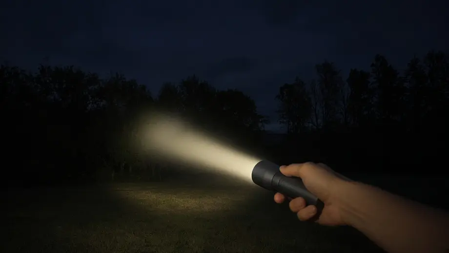

A thermal step down flashlight lowers its own output when its head gets hot, and that drop is protection, not a defect. No handheld body can shed the heat of 10,000 lumens for long. On Olight's published specs, turbo lasts 2 to 2.5 minutes, then settles at 15% to 26% of peak. Judge a high-lumen light by the level it holds after the drop.
You paid for a 10,000-lumen light, switched to turbo in the backyard, and two minutes later the beam looked noticeably weaker. The head felt hot. Maybe you wondered whether the battery was bad or the listing lied. This guide explains where the heat comes from, how to read a step-down spec, how weather and grip change it, and how to get the most from turbo without fighting physics.
