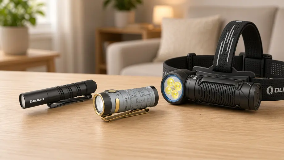

The best flashlight under 100 dollars depends on how much you spend. At $19.99 the Olight i3T 2 EOS is a 41.8 g AAA light with 200 lumens. At $54.99 the Olight Baton 4 adds a rechargeable battery, 1,300 lumens and a 170 m beam. At $89.99 the Olight Perun 3 adds a headband, red light and 25 hours at 120 lumens.
This table puts the three budget flashlights side by side on Olight's published ratings.
| Spec (Olight rating) | i3T 2 EOS | Baton 4 | Perun 3 |
| Regular price (September 2026) | $19.99 | $54.99 | $89.99 |
| Max output | 200 lumens | 1,300 lumens | 3,000 lumens |
| Peak intensity | 963 candela | 7,225 candela | 6,400 candela |
| Beam distance | 62 m | 170 m | 160 m |
| Output steps at max | 200~100 lumens, 7 + 28 minutes | 1,300~600~300 lumens, 1.5 + 2.5 + 73 minutes | 3,000~800~600 lumens, 2 + 180 + 30 minutes |
| Longest steady mode | Low 5 lumens, 21 hours | Med 60 lumens, 8 hours; Low 12 lumens, 35 hours | Med 120 lumens, 25 hours; Low 30 lumens, 89 hours |
| Weight with battery | 41.8 g | 52.5 g | 150 g |
| Water rating | IPX8 | IPX8 | IP68 |
| Power | 1 x AAA (alkaline included) | 650 mAh 16340, 2.34 Wh | 5000 mAh 21700, 18 Wh |
| Charging | Replace the battery | MCC magnetic cable, about 1 hour | MCC3 magnetic cable, under 4 hours |
| Switch | Tail switch | Side switch | Side switch |
All three manuals state that their tables were "tested per ANSI/PLATO FL 1-2019 standard in Olight's labs for reference," and each lists a 1.5 m impact rating and a working temperature of 0 to 40 °C.
Olight i3T 2 EOS: The $20 Pick
The Olight i3T 2 EOS flashlight ($19.99, regular price, September 2026) solves one problem well: it runs on a single AAA battery, which you can buy at almost any store. Olight rates it at 200 lumens, 963 candela and 62 m, IPX8, at 89 mm long and 41.8 g with battery. Its High mode runs 200 lumens for 7 minutes, then 100 lumens for 28 minutes; Low gives 5 lumens for 21 hours.
The tail switch is simple. The i3T 2 EOS user manual says a light press turns it on momentarily, a firm press clicks it on, and you can set which level it starts in. Olight also says a protected 10440 Li-ion cell (maximum length 44 mm) can raise output to 300 lumens, but that cell is not included, and every rating in this guide uses the included AAA.
The limit is endurance. One AAA holds about 35 minutes of useful High output, so the i3T 2 EOS is a backup light, not an outage light. Its 62 m beam also falls short of the 150 m test. The manual warns not to give it to children to play with, "in order to avoid accidental swallowing."
Olight Baton 4: The $55 Pick and Overall Winner
The Olight Baton 4 EDC flashlight ($54.99, regular price, September 2026, OD Green; several colors were listed as sold out) is 63 mm long and weighs 52.5 g, yet Olight rates it at 1,300 lumens, 7,225 candela and 170 m, IPX8. Its full mode list: Turbo 1,300~600~300 lumens for 1.5 + 2.5 + 73 minutes, High 600~300~60 lumens for 7 + 72 + 16 minutes, Med 60 lumens for 8 hours, Low 12 lumens for 35 hours and Moon 0.5 lumens for 30 days.
For a one-light owner, the manual adds three useful details. A two-second press from off locks the switch, which stops the light from turning on in a pocket. An auto shut-off timer can be set for 3 or 9 minutes. And the magnetic cable recharges it in about 1 hour.
The limits are real. The standard Baton 4 charges through its MCC magnetic cable, not a USB-C port (the Premium Edition's charging case can also recharge it), so if you lose that cable, you need a replacement MCC cable. If magnetic cables and customized cells are your main doubt, our guide to is Olight worth it weighs those tradeoffs line by line. Its steady Med mode lasts 8 hours, short of the 10-hour outage test used in this guide. And it has no headband or red light.
Olight Perun 3: The $90 Pick
The Olight Perun 3 headlamp ($89.99, regular price, September 2026) is a flashlight and headlamp in one. Olight rates it at 3,000 lumens, 6,400 candela, 160 m and IP68, and lists a headband, magnetic tail, clip and lanyard. Modes: Turbo 3,000~800~600 lumens for 2 + 180 + 30 minutes, High 600~120 lumens for 300 + 30 minutes, Med 120 lumens for 25 hours, Low 30 lumens for 89 hours, Moon 5 lumens for 20 days, and red light at 60 lumens for 14 hours or 15 lumens for 70 hours.
Its 18 Wh battery is the reason it wins outage and camping jobs. The National Park Service's Ten Essentials guidance says, "Headlamps are the recommended light source because they are hands-free." The Perun 3 is the only light of the three that fits that advice.
The limits: 150 g is almost three times the Baton 4, the full charge takes under 4 hours, and Olight's product page notes that the headlamp mounting bracket "is METAL - it is expected to scratch the body of the torch if taken in / out repeatedly."
