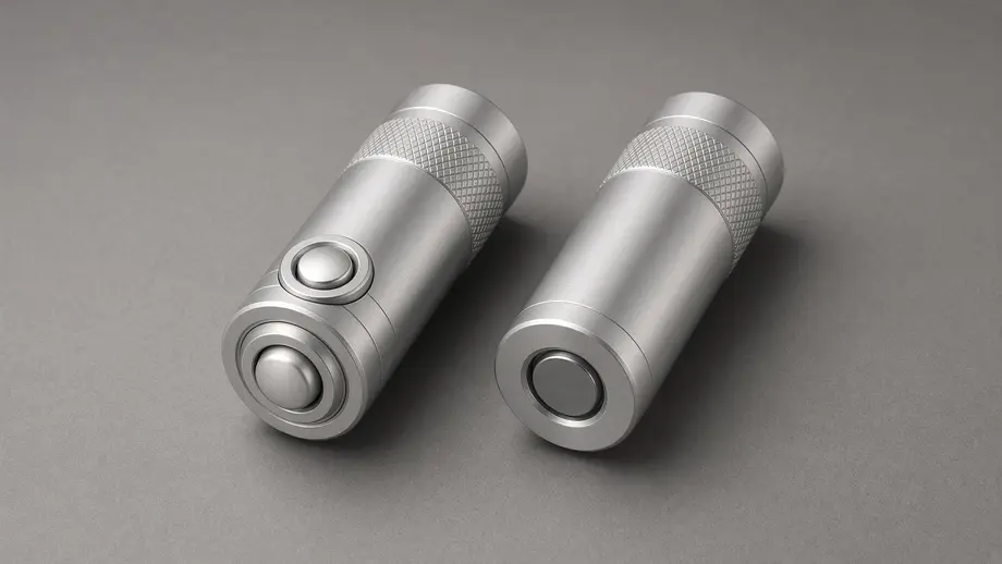

Tailcap Cost: Press Life, Instant-On, and Accidental Activation
A tactical tailcap earns its price in the first second of use. You press it with your thumb while gripping the light like a hammer, and the light comes on at once and goes off when you let go. A harder press jumps straight to turbo. On the Warrior 3S, the factory setting gives Medium on a half press and Turbo on a hard press, according to its user manual.
That two-stage design is the main thing you pay for. A side switch needs a click pattern to reach turbo; the Warrior 3S manual says a fast double click on the side switch enters Turbo and a triple click enters strobe. A tail switch does it in one press, with the same thumb position every time, which is easier to repeat under stress or with gloves.
This table compares the tail switch behavior of each light, taken from the Olight user manuals.
| Light | Light press or tap | Firm press | Press and hold | Alternate setting |
| Warrior 3S | Medium (Configuration 1) | Turbo | Momentary on, off when released | Configuration 2: half press Turbo, hard press Strobe |
| Warrior Ultra | Medium (Configuration 1) | Turbo | Momentary Medium or momentary Turbo | Configuration 2: tap and hold for momentary Turbo, press firmly and hold for Strobe |
| Warrior X 4 | Low, 300 lumens (Regular mode) | High, 2,600 lumens | Momentary Low or momentary High | Tactical mode: tap for Mid (1,000 lumens), press for Strobe |
| Baton 4 | No tail switch | No tail switch | No tail switch | Side switch only |

- A momentary tail switch. Press and hold should mean light on, release should mean light off.

| Night-shift security or patrol | Warrior 3S | Two-stage tail switch, 805 lumens for 160 minutes after turbo | Magnetic-only charging |

- Read the tail switch section of the manual. Confirm momentary-on, and decide which configuration you want before the light arrives.
